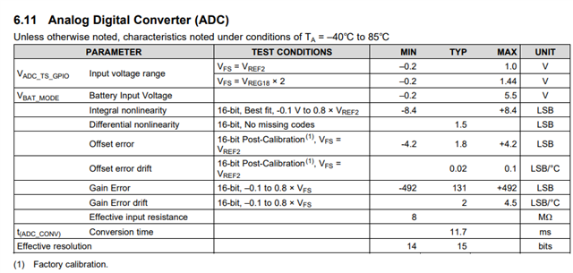

Hi Team,
Could you please tell me the BQ27Z561 Internal ADC sampling frequency and sampling accuracy? Thanks.
BRs,
Dillen Chen.
