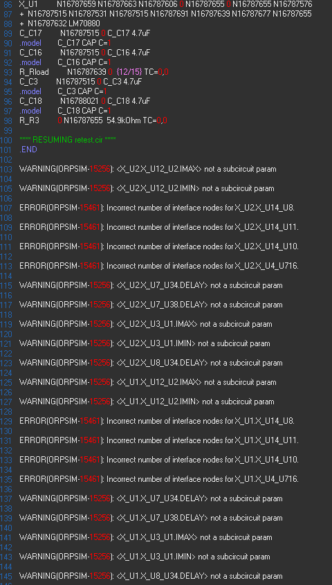

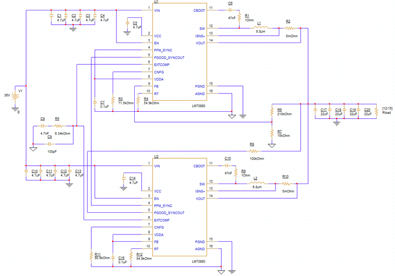

I was looking at suitable buck converters for an application of up to 48V input voltage, 12V output voltage at 15A. I identified using LM70880-Q1 in parallel as my only option. After reviewing the datasheet I am still a little confused as to how I would design the component in parallel, as from what I have seen, neither Webench or the Quickstart calculation tool support parallel modelling unless I am mistaken. Would I be able to be provided an example design for my application or a similar design that I could use as a reference?
