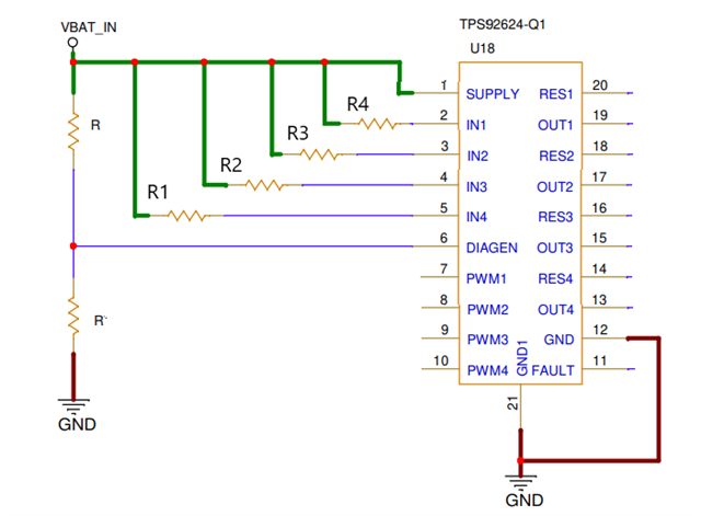

Dear Ti Team,
We are using below LED Driver.
input : 10V to 18V, output 5Volt LED.
output 200mA /per channel current 50mA
output 400mA /per channel current 100mA
output 600mA /per channel current 150mA
R1, R2, R3, R4 are current setting resistance.
we are using 0402 package 60mW resistance in current setting, is 60mW is sufficient or we need more power resistance. 0603 package power 100mW & 0805 package power 250mW
    Do you need to know the resistor power limit for each current output? You will need multiple drivers with different Resistor values for current sensing in order to achieve the specifications listed
  • Hello Daniel,
    The customer want to know if suppose for all 4 channels to get 600mA load output they will say use maximum capacity of TPS92624-Q1 which is 150mA per channel and accordingly for setting say different different current out for same IC they will select resistor setting accordingly.
    Now, the question is if say at max out of 150mA per channel they are using say "Rx" valued resistor of 0603 package to support the dissipated heat will for the same current setting can 0402 package resistor work here (this doubt is coming to reduced down to cost on package being used), for 0402, 60mW is allowable power dissipation so that it doesn't get derate within these limits.
    Let the customer know whether 0402 can be used here or you recommend to go for some other package with more allowable power dissipation?
    Jinesh
  • Hi Jinesh,
