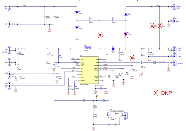

i am working on a design where i should boost from 3V to 35 or 45VDC
i am using TPS61391, the load current is null ( less than 20µA)
i tested the TPS61391-eval board and i noticed that the current consumprion of the evaluation board is 15mA at no load,
i am operating on a very small battery that can't allow that current,
the Iq of the tps61391 in the datasheet is <1mA
I did not found an explication for that, can you help to understand why the dev board is consumming 15mAon the 3V side ?
best regards
Ziad
  • Hi Ziad,
    The TPS61391EVM has many additional function blocks, such as a positive charge pump to 70V, a negative charge pump to -35V, and APD power.
    If you use the boost function only, please try the modifications shown below and then measure the current consumption at no load again.
    Thank you.

  • Hello Lei
    Thanks for your feedback
    i desoldered the requested component, we passed to 10mA over 3V on the input
    it still not acceptable for our design
    do you have any idea why it is overconsuming ?
    best regards
    Ziad

  • Hi Ziad,
    I verified on EVM and observed similar input current when no load.
    The Rdson of TPS61391 is big. When Vin = 3V and Vout = 48V (For the EVM I verified, the Vout = 48V. When Vout = 45V or 35V, there should be the similar behavior) even there is no load, the device still works in DCM mode with frequency around 700kHz. So the efficiency is very low.
    That's why with a 0.34mA(from datasheet) internal Vout leakage, there will still be around 15mA input current was consumed.
    Will it be available to add a EN/disable signal in your application and disable the TPS61391 when there is no load?
    Lei

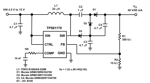

  • Hi Ziad,
    Is the 35V or 45V Vout needed all the time for the load? If the 35V or 45V Vout is needed only to active the load in short time, you may use an EN signal to enable/disable the device.
    If the device should be enabled all the time, sorry there may be no effective ways to decrease the input current.
    Other possible solution is to use a boost with pulse-skipping PFM mode and a charge pump to generate the 45V Vout. Following is an example. Could you provide more accurate for your Vin range? So I can search more suitable device if this solution is acceptable.
    Lei
