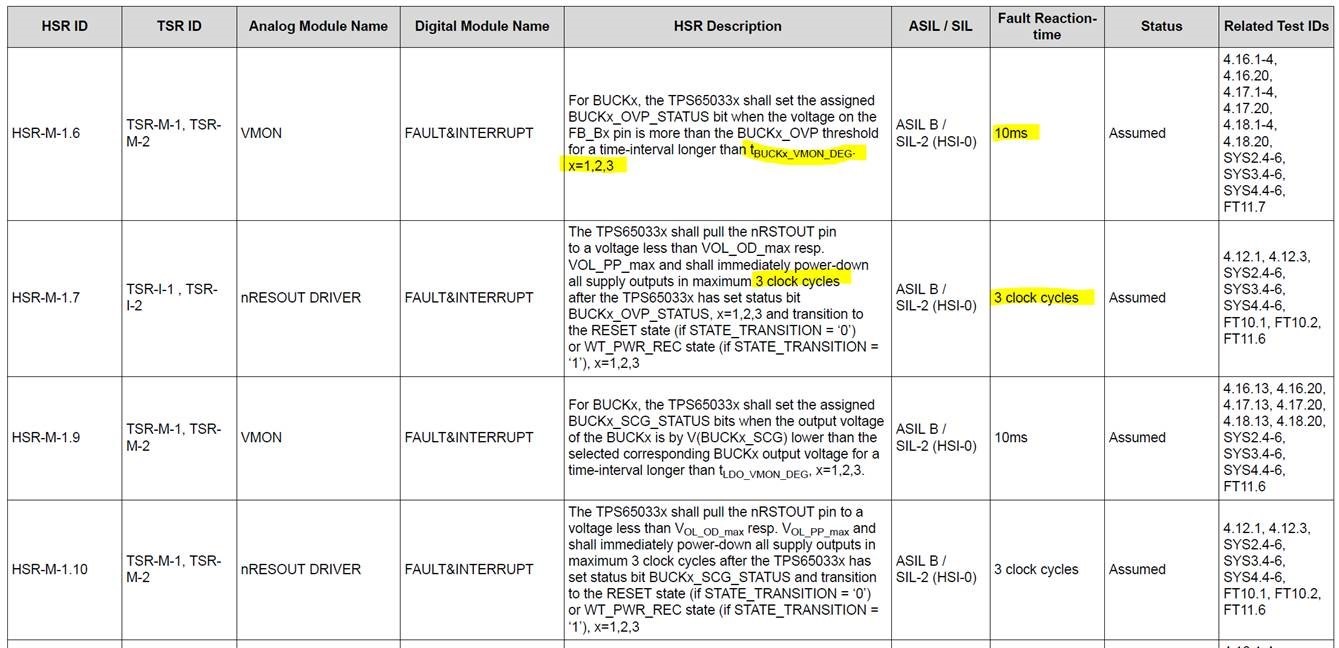

The SM's reaction time information can be found in the HSRs, which are included in the Functional Safety Analysis Report Summary. Example:
Note: for some there is a dependency on configurable settings like deglitch-time.
