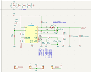

TPS923652: schematic to review
Part Number: TPS923652
Hello guys,
made this circuit around the TPS923652.
it should regulate 600mA @ 21Vout.
I am supplying from 8-34V input range.
i have made a quick prototype, and tested on a dummy load at both 8V and 34V (the two extremes...).
In both cases the part fails to make its job. I get a very low voltage at the output (~7v). no 0.2V across the sense resistor. no current flowing on the load.
Can you spot some errors in my implementation ?
thanks
