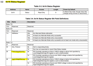

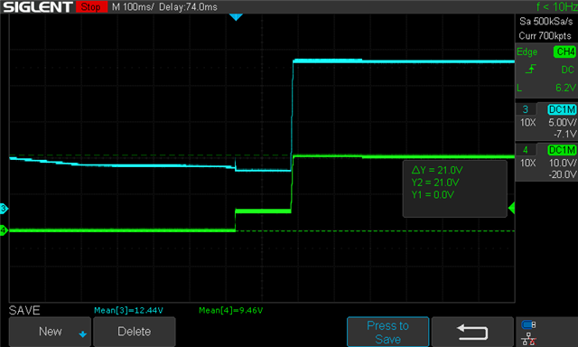

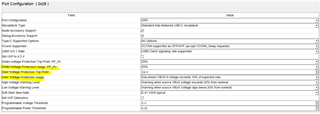

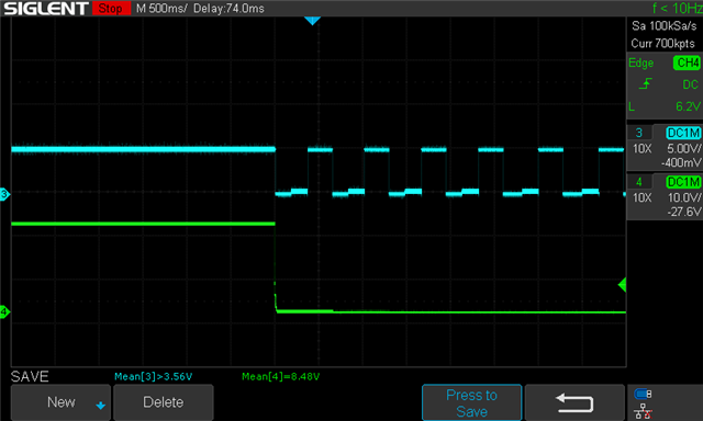

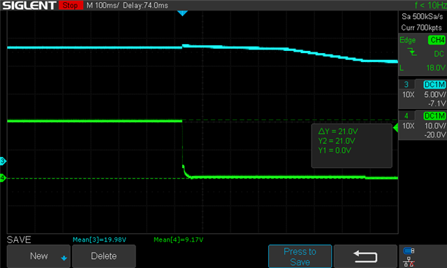

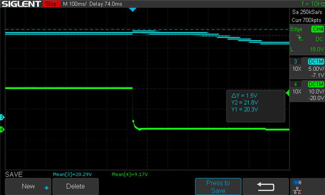

I'm working with the TPS65987D USB PD controller and experiencing an issue where the VBUS output voltage cycles on and off. The output reaches 20VDC, stays on for a few seconds, then shuts off for a few seconds before repeating the cycle.
This seems to be related to the specific device we're trying to power, but it's crucial for our application, so we're looking for a solution. Has anyone encountered this issue before, or have any suggestions on how to stabilize the VBUS output?
Any help would be greatly appreciated!

  • Hi Raymond,
    Below is a scope capture of the disconnect. The Blue line is the input to PP_HV2, the Green line is VBUS. After the initial connection the voltage stays stable at 20VDC for about 5 - 10 seconds then randomly turns off. This cycle repeats every few seconds over and over.
    Second scope capture of the disconnect.

    This last one is with the CC line. The Blue line is the CC, and the Green is still the VBUS.

    How much current is being drawn by the far-end device? Can you capture PD (CC) logs and share it here? From the waveform you provided the VBUS voltage seems to be stable and not within a OVP or UVP state. It might be a possibility the far-end sinking device is the one disconnect and not TPS65987D.
    If possible, can you read back the status register (0x1A) and see if the LowVoltageWarning or HighVoltageWarning is toggled? The fields are highlighted in the screenshot below:
    If it is a case of OVP or UVP, you can configure the OVP/UVP thresholds through the GUI in Port Configuration register (0x28) as shown below:
