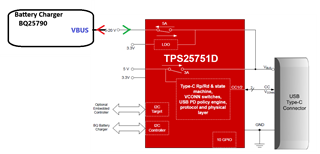

    2. I like more the TPS25751D due to its Integrated 20V, 5A, 16mΩ bi-directional load switch so if we are using it along with lets say BQ25790 then I am assuming in case of no external power and we are the source (from battery) then BQ25790 will provide 5-20V on VBUS as shown below. Please confirm if this is correct?

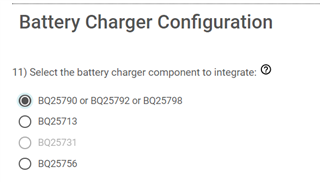

    This device does not support ALT mode. Since that is the case, the best PD controller to use here would be the TPS65988DK. It supports Alt modes, but you would have to handle the writes to the BQ between the PD. There is an I2C controller events table that you can use to make the writes for whatever BQ device you select.

    Regarding writes you can use either the PD or MCU! There is an I2C controller events table on the PD config tool that you can use to have the PD write to the BQ.
    Yes that is correct!
