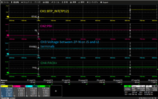

    1) In the diagram of the BTP_INT buffer configuration that you replied to the other day, it appears to be an open-drain output of the PBI terminal voltage, but when I actually checked the waveform of TP12 on the bq40z50EVM, this was not the case, and approximately 4.6V was being output.
    In this configuration, the voltage of a 2S battery is divided according to Figure 1-3. Resistor Divider Network of SLUA999 (A simple Battery Simulator) and input to the J2 and J5 terminals of the EVM.
    I have attached the waveforms so I would appreciate your opinion on the reason for this.
    2) In the above waveform, immediately after powering on the bq40z50EVM, the voltage on the PBI terminal is lower than the voltage on PACK+.
    This seems to contradict your previous answer, "The PBI terminal and the BAT terminal should be at the same voltage." Can you explain the reason for this?
    Kagawa
    I have confirmed with our hardware team that this is a push/pull pin.
    From the waveform, the difference between BAT and PBI seems to be ~300mV, which I believe is normal. This decrease may be being produced by the internal function of the gauge.
    Anthony

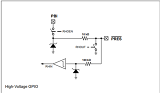

  • Hi Anthony-san,
    If the BTP_INT pin is a push-pull type, then a 10kΩ pull-up resistor from PBI should not be needed.
    However, I am unclear why this configuration is considered equivalent to a “high voltage GPIO”. Please explain the following two points.
    1. The timing at which RHOEN and RHOUT switch in the “High-Voltage GPIO” shown below.
    2. If an external pull-up resistor is required for the BTP_INT pin, what is its resistance value and voltage?

  • Hi Kagawa,
    Please allow me to confirm this with our design team.
    I believe these values would rely on the application and host that is receiving the signal.
    Response from our design team:
    "The switching times are all slow speed, but there's no concern regarding an overlap period in the design."

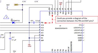

  • Hi Anthony-san,
    This measurement result was obtained with the bq40z50EVM evaluation board.
    In the bq40z50EVM circuit diagram, the internal connection of the PBI and BAT terminals is unclear.
    Could you provide a connection diagram of the PBI and BAT terminals?
    In addition, regarding the "internal function of the gauge" mentioned, if there is a possibility that a potential difference between the BAT and PBI terminals may be generated, please tell us the function, register setting value, etc.
    Kagawa
  • Hi Kagawa,
    Below is the Power Supply Control Diagram from the datasheet:
    I was corrected by our design team that the voltage drop could be caused by the diode in series with the BAT pin, and that the internal function of the gauge should produce the same voltage at each of these pins. Please allow me to get more clarification from them.
    Anthony

  • Hi Kagawa,
    The information I have received from the design team is that this difference could be coming from the diode in series with the BAT pin. Typically the voltage directly received by the BAT pin should be the same as the PBI. Please let us know if this difference has been seen on multiple devices.
    Anthony
