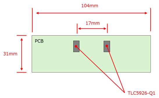

My customer use PWM input on OE pin and they have troubled when PWM input is 100%(always High).
In that case, IC surface temperature rises by about 7°C. In my understanding, OE=H means output drivers disabled so I don't think that occur such temperature rise.
