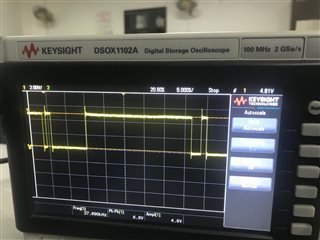

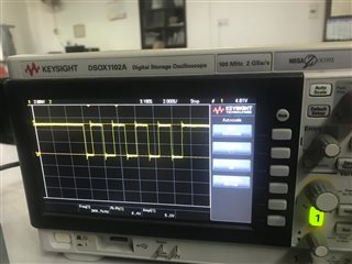

  • Benjamin,
    I have tried the suggested method by declaring the device as both base and top of stack, but still I am not getting any response. Additionally, I also tried by performing single device read/write by taking the default address i.e., 0x00. Please find attached below the software reference and also the data I tried to send observed at the RX pin of the evaluation board. Data at RX pinData at RX pinThe default addressSoftware design reference.
    Please suggest me some other method as I currently dont have an access to a logic analyzer.
  • Priyangsi,
    I noticed the synchronization commands go to 0x34B when they should stop at 0x34A and that you are auto-addressing to three devices but you seem to also indicate there is only one device in the stack.
    Can you have the program print all of the commands that you send to the EVM? Double check that the baud rate and serial protocol are as indicated on the datasheet:
    Additionally, could you check that the TX pin of the EVM actually shows no sign of response?
    Finally, you can find our reference code here
    Ben
