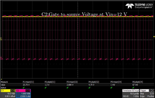

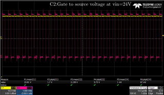

We have faced few below mentioned  problems with LM5176-Q1 when we tested With PCB. The schematic attached for your reference
  1. It is not boosting 24 V from 9 V input but it is working from 10V. However the Vcc voltage is 4.3 V at 9 V and 4.7 V at 10V (as per datasheet it should give 7 V figure 6.4 (VCC vs Vin)). Attached gate to source voltage Q10.
  2. From 9 to 10 V there was inductive noise and the output voltage was 6 to 8 V. (Don't why it is not boosting 24 V)

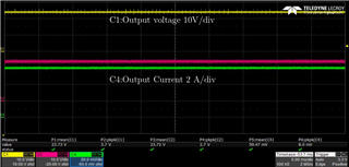

  3. From 12 V to 15 V there was a proper 24 V but the inductor heated more  at this condition. attached image for your reference.
  4. Above 5 A load current @24V there was 3.0 V p-p ripple in output voltage but less ripple at below 5 A.    Schematic
