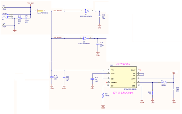

TPSM33625: IC gets damaged when Vin=28V
Part Number: TPSM33625

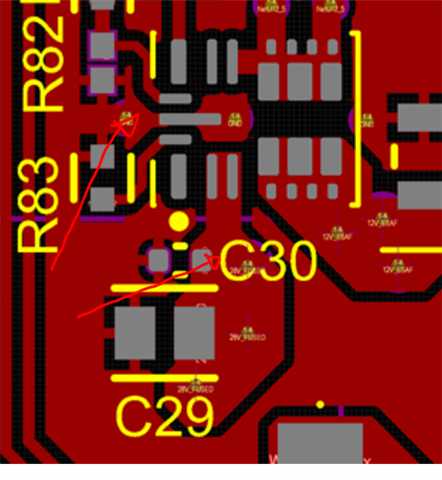

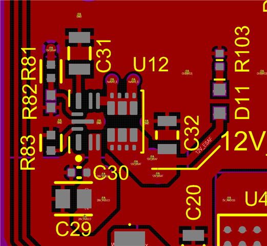

Applying 18VDC to the input of the enclosed circuit works.  However, applying 28VDC fries the IC.  This part is rated for Vin=36V (Abs.Max=40V), so I'm not sure what's causing the failure.  There is no load on the 12V output.  There is no overshoot on the 28VDC that is applied to the input.
Please advise ...
