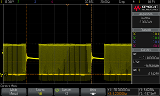

The circuit generally works as expected, we can start and stop charging and vary charge current via I2C. Layout is appears pretty good and switching edges are clean with very minimal ringing. However, the design never seems to enter PFM mode at lighter (~500mA) charging current but instead goes straight to discontinuous mode, even before reducing the inductor on/off ratio significantly. This is despite never changing the default 'enabled' for PFM mode. We can read back "REG12_Charger_Control_3 Register" and confirm it's 0x00. Writing 0x10 to this to disable PFM makes no difference and neither does writing it back to 0x00.
Sometimes we get periods of bursts of DCM mode and then off, which can result in audible (and I'm told very unacceptable) high frequency tones.

    The ceramic capacitors are likely the source of the ringing due to their piezo-electric nature.  Unfortunately, there are still some conditions where the charger enters DCM.  Can you reply with a oscilloscope shot of VBUS, SW1, SYS and if you have a current probe, inductor current, when the noise occurs?  If using an EVM you can desolder the inductor, stand on one edge, solder to one pad and then use a piece a wire to make a loop for the current probe.
  • I haven't had chance to progress this much further yet but can confirm that I have now seen PFM in certain circumstances. For anything other than large charge currents there are periods of no inductor current (DCM) in every cycle, which I guess makes sense to maintain the in:out voltage ratio. Also, I didn't think through the minimum FET on time and quite high switching frequency, which I guess prevents low inductor on:off ratios (without operating frequency reduction).
    Any ideas why it's 'bursting' operation at ~9.9Khz (plot at SW1)? This is audible. I get that it's probably piezo effect of caps, but why this operation in audio band?

    At Fsw=1.5Mhz, you are correct that there is a min controllable FET on time at high duty cycle.  Just before entering buck-boost, the PWM control can turn off the FET for a brief time and then turn back on.  This can be in the audible range.  If you lower to fsw=750kHz, does that prevent the noise?  Your VIN to VOUT didn't seem close to max D, though.

    Lowering fsw to 750kHz does not change the frequency of the noise.
    This problem is only visible when the battery is close to full charge (BATP > 8.2V). The voltage on SYS and BATP oscillates between 8.0V and 8.75V with SYS slightly higher and leading in phase. This appears to be switching the BQ25792 between CC and BAT_OVP mode - we see the voltage on BATP rise while the charger is running (and SW1 has switching waveforms) and then fall in PFM mode (presumably as the BAT_OVP discharge resistor being applied). This transition happens somewhere between 2kHz and 10kHz, depending on battery and bus voltage. If this oscillation is above ~4kHz, this does not trigger any interrupt from the charger, if we can slow down the oscillation to around 4kHz, we get interrupts for a state change between CC and CV mode, but never a BAT_OVP fault.

  • Hi Jeff,
    Traces attached. Green is battery voltage, yellow is SYS and blue is IBAT with positive being into (charging) the battery. VPP is on the measurement screen on the scope trace. Average values for SYS is 8.4V, IBAT is 980mA, VBAT is 8.3V.
    I've done a few more measurements and think it does look to be that the BQ25792 is very sensitive to series resistance between the battery pin and the battery itself. We have a bit of input protection / filtering with a total resistance of around 0.1 ohm. If I bypass this, the battery voltage at which this oscillation starts to appear increases significantly (from around 8.25V to 8.33V) suggesting that this is an artifact of the charger seeing VBAT + I * R and then oscillating when this is enough to trigger CV mode but VBAT alone (in the absence of charging current) results in CC mode being the correct mode.
    One thing worth noting is that I have derived the values for when the oscillation starts using a 2 quadrant power supply which I'm aware is not the best thing as it's unlikely to respond fast enough to keep the voltage stable if we're worried about 10s of kHz. We do still see these oscillations using real batteries - the image above was taken with a real battery and I'm just waiting for one to charge up enough to trigger this behavior with bypass input protection but the PSU is nice to quickly quantify whether this made a difference which it clearly does - reinforcing my theory that this is an ESR related problem.
    Do you have any data on maximum ESR / ESR related ripple allowed for stable operation of the charger? I'll get some data with a real battery shortly. I saw somewhere on this forum that you have a BQ25798 that fixes the charger making audible noise when no battery is present which feels like the same behavior as we're seeing here, just caused by different reasons. Is this part worth consideration (despite not appearing to be easy to get hold of currently)?
