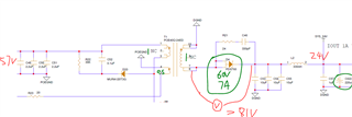

The POE+ power supply I have designed following the data sheet etc., for the TPS23754, when connected to a POE++ (Injector) supply of about 56V will pulse and seems to think it is overcurrent. However, when I connect to a POE+ supply (switch) of about 48V it will boot up normally. I have used the POE++ injector, POE+ switch, and various others with other designs and no issues.
The power supply provides the required voltage, 24 VDC, and my target output power when loaded with audio on POE+.
However, the supply seems to think when connected to the POE++ injector that there is either an over voltage or over current. It "hiccups" and repeatedly restarts. This is at minimum load of about 250mA, we're powering a Beagle Bone Black clone pcba with a 25W Class D TI amp, an ADAU1452 DSP, 5 op amps, and an ethernet Phy chip.
Classification resistor is 63.4 ohms.
Schematic attached.
Thank you!

    The major cause could be the overvoltage of D4 diode which is rated for 60V. When you have 57V input, the voltage at that diode would be more than 57V/Npri*Nsec+24V=81V. It is recommended to use 100 V or 150 V rated diode for this applications. PMP22301 (https://www.ti.com/tool/PMP22301) is a 24V output reference design using TPS23754 which you can refer the schematic.

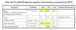

    Besides, it is noticed that 4 x 0.1uF caps are used between VDD-VSS. The PD standard detection cap is 0.05 - 0.12uF. It is recommended to DNP the first 3 x 0.1uF caps.
    And for 24-V output, 220uF AL cap seems too big. It is recommended to use a smaller cap like100uF.
    Diang
  • Hi Diang,
    Long time no see!
    As to the multiple .1 caps I agree-but for the EMI/EMC testing sometimes they are necessary.
    If all else fails I will eliminate them during bench testing and see what happens.
    I think i will DNP the 3 of them and if I fail conducted or radiated at EMC lab I can repopulate them easily 1 at the time.
    We've always used the 3 caps without issue other POE designs.
    I'll downsize the 220uf to 100uF.
    I agree with your analysis of the diode, I've ordered some to replace the ones we are now using.
    Also, I've read in other threads in the forum where TI recommends upsizing the C33 to say a 10uF to slow down the current ramp to allow the supply to stabilize with a deep inrush current. Would this help me keep my 220uF?
    l will implement these changes and let you know what i find.
    I've already been looking at the PMP22301.
    Thanks again!
    Ray

    The IEEE 802.3 standards require a PD with detection cap 50 - 120 nF. Passive PoE injector is not in standard and it can power on the PD without detection.
    Reducing the 220uF cap is not mandatory as well as it won't cause peak power test failure in Sifos standard tests. You can also try to increase the C33 to make the soft start period longer.

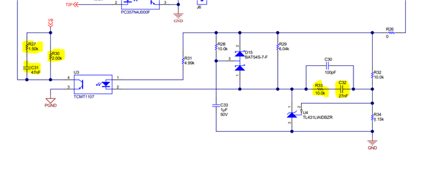

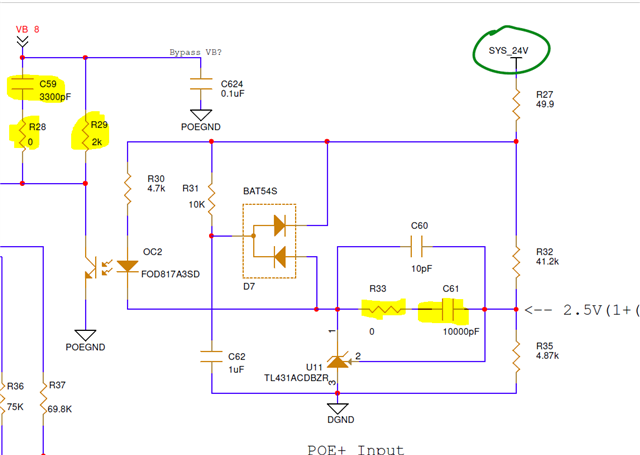

    For your issues of hiccup, possibly by inrush or surge current failure, it may be worth to run the test with C622 = 220uF DNP. Meanwhile, sometimes adjusting the feedback RCs can help to address too high surge current response too. You could try with the PMP22301's values.

  • Hi Diang,
    I have solved the problem, I increased (on my schematic) the capacitance parallel to C512/C620 by adding 47uF.
    The stability issue is resolved.
