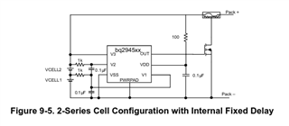

The datasheet 'BQ2945xy Overvoltage Protection For 2-Series and 3-Series Cell Li-Ion Batteries' states:
Page 10
9.2.2 Detailed Design Procedure
2. Determine the number of cell in series. The device supports 2-series to 3-series cell configurations. For a 2-series configuration, the V3 pin is shorted to V2.
Page 11
9.3 System Examples
V3 is connected directly to the Pack+ rail without an RC network.  Page 8 subsection 8.4.1 NORMAL Mode "The device monitors the differential cell voltages connected across (V1–VSS), (V2–V1) and (V3–V2)".  This direct connection to Pack+ looks as if it could lead to a potentially erroneous triggering of the output drive.
Our design has opted to short V2 and V3 for a two-cell configuration, however, please can someone clarify the contradictory information?
