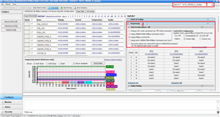

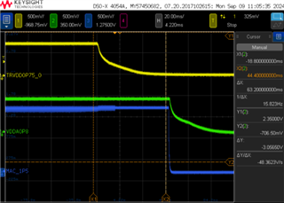

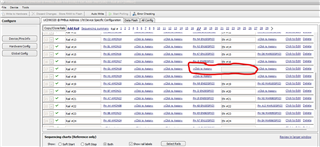

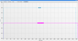

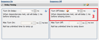

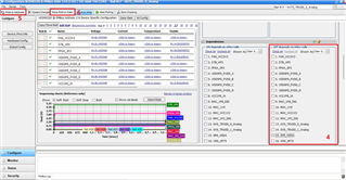

We tried adjusting the power-down sequence for Rail#17 to make it power down after Rail#24.
But no matter what I do, it's not working.
Could you please help check which steps were wrong?
Setting SOP:
Setting SOP:
According to your project file, the enable signal Rail #17 does not come from the UCD90320. In this setup the UCD90320 can monitor the rail voltage, but not control turning the rail on or off.
As such Rail #17 will power down when it's external enable signal goes low, regardless of what the UCD90320 is doing.
If you want Rail #17 to power down after Rail #24, the external enable will need to be tied to Rail #24 in some way, or the enable will need be provided by the UCD90320.
