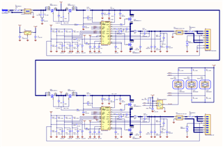

BQ24610: 2 series battery carger
Part Number: BQ24610
This is the sch of 2 series Li-ion Battery Charger using BQ24610.
Pls advice to avoid IC broken below situation (like EOS durability test).
Basically it operates as expected, But U201 is broken the situation below.
/ No DC input (witout AC adaptor)
/ 2 full charged batteries attache and detach to the connector at each charging port.
