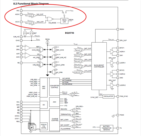

2. Focused on avoiding this reset we think this might be related to the REGN LDO block in the BQ25756 device, we see here that this REGN LGDO can be powered up either from VAC or VSRN, so we were wondering if this possible to change the power source from VAC to VSRN to avoid this reset.

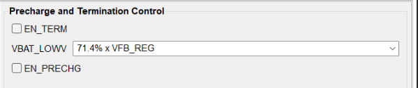

3. Another problem we do have is that with precharge and termination disabled, the device indicates that the battery is always in the CV  operation mode of charge independently if we are charging in CC  or CV charge. Could this be a software error or is there something we are missing?

    2. The IC should do this automatically
    3. That's strange. What's the charge current and battery voltage where the device always reports that it's in CC mode? The device should only report that it's in CV mode when the FB pin reaches its set voltage. Does setting EN_PFM=0 change anything here?

    3. Our input conditions were 24 Volts, our battery voltage 26 volts, We didn't change the value of the EN_PFM bit, we left it to its default value, is it necessary to modify this to see a change between CV/CC?

    2. I think it's a diode OR function.
    3. What's the battery termination voltage or charge voltage here? Have you changed the FB pin feedback resistors?

    3.Yes we have changed the FB pin feedback resistors we've reduced this resistor by 10 times. The charge voltage is 29.4 Volts and there are 1.536 in the FB pin

    3.Yes we had the same charge voltage value but we still obtained CV when we really were in CC mode of charge. Is this an IC error?
    I don't think this is an IC error. Make sure EN_PFM is set to 0 when the charge termination current is less than 2A.
