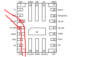

    It is possible with very careful routing to use the TPS25865-Q1 in parallel with a seperate HUB or controller that provides CDP and SDP functionality to fufill the full BC1.2 specification.
    If the USB signals are carefully routed as shown for the port A side, then the TPS25865AQ1 can provide the DCP and current limit portion of the spec while the other device sets the CDP/SDP signaling.
    I drew a quick example on the package footprint that assumed VIA in pad was ok, but the vias can be moved to the left if your design rules require it.  The routing is very critical to make sure that the stub length to connect to the TPS25865AQ1 is a short as possible to minimize the signal degradation.
    Chuck
