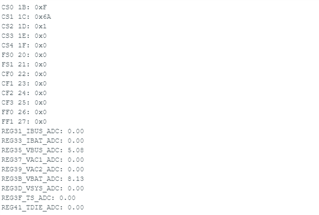

  • These are the list of register you have asked.
    Also i have noticed that when i plugged off the supply STAT LED glowing continuously, REIGN voltage of 5V is present even when supply is disconnected when disconnect battery then regn voltage becomes zero.
  • HI Gaurav,
    The charger is reporting VBUS voltage present and in fast charge.  But the ADC currents and die temp being 0 doesn't make sense.  With ADC enabled, TS pin ADC channel enabled and reading continuously, REGN stays up.
    Can you look at SW2 using an oscilloscope to confirm that the converter is switching?  There should be a square wave on SW2.

    Total Register Read
    Working module My charger PCB
    I2C REG ADDRESS 0X0 :0X12 I2C REG ADDRESS 0X0 :0X12

    I2C REG ADDRESS 0X2E :0X88 I2C REG ADDRESS 0X2E :0X88
    I2C REG ADDRESS 0X2F :0X8E I2C REG ADDRESS 0X2F :0X8E
    I2C REG ADC 0X31 : 0.00 I2C REG ADC 0X31 : 0.00
    I2C REG ADC 0X33 : 623.00 I2C REG ADC 0X33 : 0.00
    I2C REG ADC 0X35 : 5164.00 I2C REG ADC 0X35 : 5105.00
    I2C REG ADC 0X37 : 0.00 I2C REG ADC 0X37 : 0.00
    I2C REG ADC 0X39 : 0.00 I2C REG ADC 0X39 : 0.00
    I2C REG ADC 0X3B : 8307.00 I2C REG ADC 0X3B : 8000.00
    I2C REG ADC 0X3D : 0.00 I2C REG ADC 0X3D : 0.00
    I2C REG ADC 0X3F : 0.00 I2C REG ADC 0X3F : 0.00
    I2C REG ADC 0X41 : 0.00 I2C REG ADC 0X41 : 0.00
    I2C REG ADC 0X43 : 0.00 I2C REG ADC 0X43 : 0.00
    I2C REG ADC 0X45 : 0.00 I2C REG ADC 0X45 : 0.00
    I2C REG ADC 0X47 : 8.00 I2C REG ADC 0X47 : 8.00
