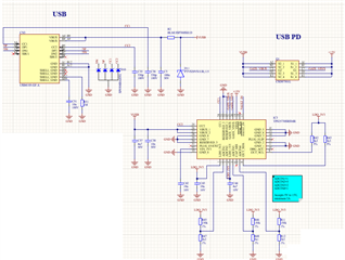

  • Hi Chris,
    No internal 3V3. Everything powered by USB.
    Please schematic part copied:
    Tamas

  • Hi Chris,
    It has a pd resistor, then if a button is pressed, a discrete circuit pulls up to about 2.2V and latches there.
    When we want to turn off the device, a GPIO turns-off the latch circuit and the FAULT_IN goes back to 0V.
    Tamas

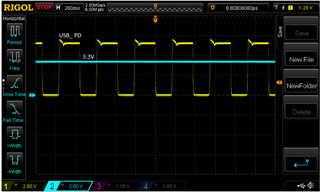

  • Hi Chris,
    Thanks for the detailed answer, really helpful.
    What is interesting in our application, even when the USB PD source is outputting a cycling 5V, our internal LDO is establishing a stable 3.3v like this:
    So therefore I think actually tieing our internal 3.3V to the FAULT_IN and VIN_3V3 seems to work.
    We are doing further investigation, will post here soon.
    Tamas
  • Hi Tamas,
    Thanks for the update.
    Where are you measuring the toggling voltage? VBUS, PPHV?
    How are you powering your system for the capture above? Do you power VIN3V3 or is this still dead battery?
    If you start in dead battery, we will power cycle on losing VBUS voltage (due to fault_in).
    Thanks and Regards,
    Chris
  • Hi Chris,
    The measurement is on VBUS, and the USB PD source is outputting this toggling 5V there. At the same time we have similar signal patterns existing on the CC line.
    In this measurement, the VIN3V3 was still left unconnected , so yes it was dead battery mode.
    For me it seems, even though there is power cycle of 5V in dead battery condition, it is let through PPHV and it is enough for our system to boot up (90mA consumption).
    The 3V3 on the oscilloscope picture is the internal 3V3 of the system, it is not the VIN3V3 of your chip.
    Tamas
  • Hi Tamas,
    Got it, yeah, when booting in dead battery, we will reset whenever we see VBUS drop (this happens due to Fault_in assereted) so the toggling is expected.
    Thanks and Regards,
    Chris
