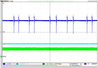

My customer is testing the trickle charger current.
Therefore, the battery is forced to be at OV,
But it was found that trickle charger current is unstable.
The design value of LC of our circuit refers to spec, 1uH & 20uF,
Later we added 22uF on the output side (VSYS),
Only in this way can trickle current become stable.
Could you please help explain the reason?
Please refer to the attached file for the waveform.
BQ25620 trickle charging current issue 1007_2.xlsx

    Below are my test results with BQ25620EVM. As you can see there is no indication of charge current instability when in trickle charge.
    CH1 (blue) = SW; CH2 (light blue) = VBAT; CH4 (green) = Ibat
    -200us/div
    -20us/div
    Where are you measuring trickle current on your board? is it on the input side or the output side of the BQ25620 device? When operating at such low output current some ripple is expected on the input current draw because converter is operating in PFM (pulse frequency modulation) mode rather than PWM mode.

    1) At this point in time I cannot say. It is not expected and we are unable to observe the same instability testing BQ25620 in our lab. Are you sure the provided current waveform is taken at BAT pin? In my testing I can observe similar current waveform at VBUS input, but as the waveforms above show I observe no instability at output of BAT pin.
    Does the same ICHG current instability exist if you test with a higher battery voltage still in the trickle charge range such as 1V VBAT? Is the battery voltage stable during the time when current instability is observed?
