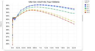

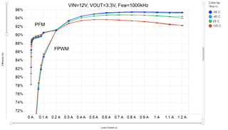

Could you show me figure of Efficiency vs Ambient Temperature at LMR43606-Q1 and LMR43620-Q1 ?

What input and output voltage are you looking for and at what ambient temperature?

LMR43606-Q1 : Input 12.0V, Output 5.0V
LMR43620-Q1: Input:12.0V, Output:3.3V
Temperature : -40℃ ~ +125℃

Thank you for this additional information. Let me check with the team on the available data. Expect an update by the end of the week.
Denislav
Here is some temperature reference data I received from the team:
5V output:
3.3V output:
