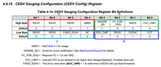

May I know how to get cycle threshold?
According to TRM, the cycle threshold is Cycle Count Percentage (default 90%) x [CEDV Gauging Configuration= 182Ah when CCT=1 or Design Capacity= 6900mAh when CCT=0]
It looks the CCT=0 based on "CEDV Gauging Configuration= 182Ah", whether the cycle threshold is 0.9 * 6900mAH= 6210mAh?
So the cyclecount is +1 if the discharge over 6210mAh, am I right?
