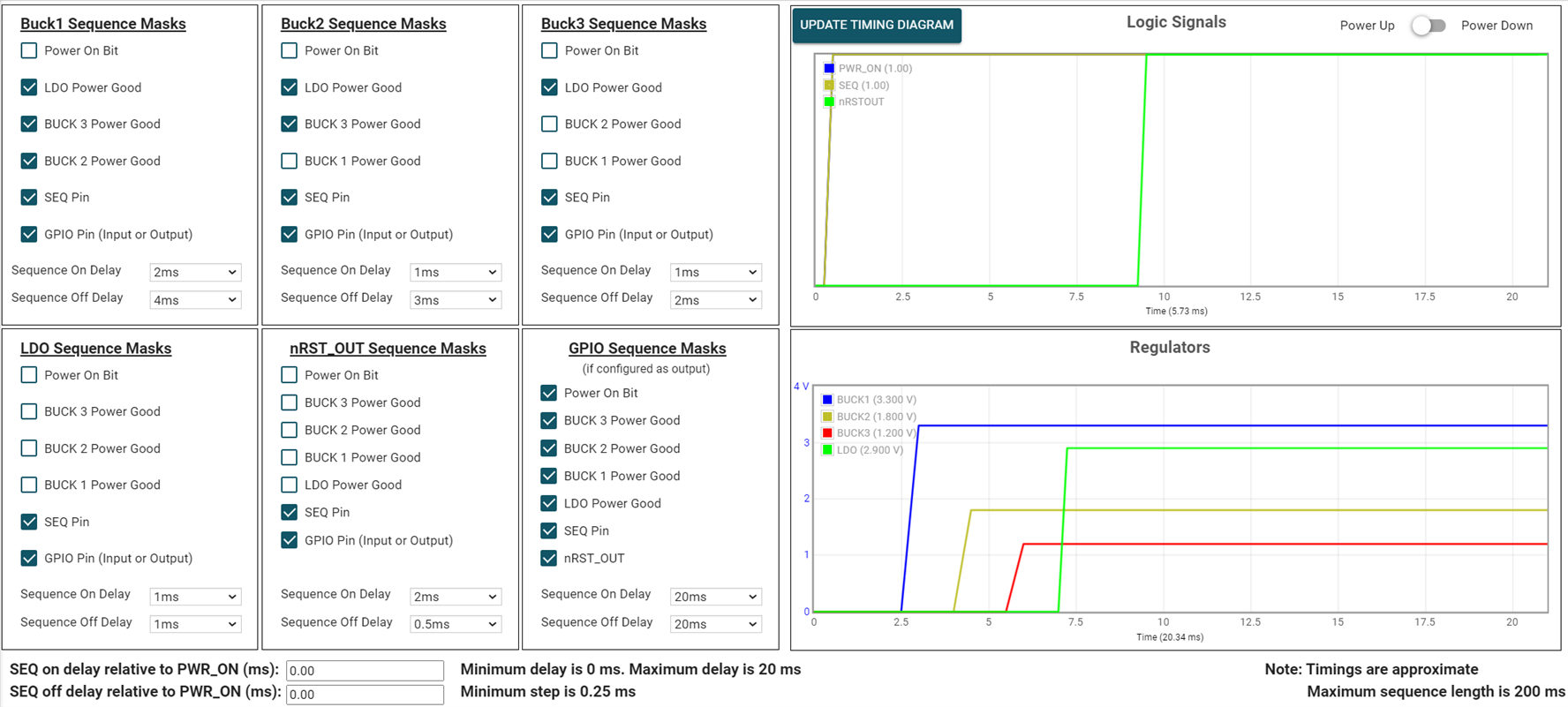

I'm using the TPS65033303RGERQ1 to power my board and a C2000 series microcontroller. I don't need the Buck2 channel. Is it safe to ground the PVIN_B2 pin and leave the LX_B2 and FB_B2 pins floating?
Will this have any adverse effects on the other channels or the stability of the system?
