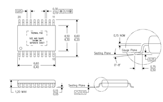

Can you please provide the height for part number TPS77733PWP. The mechanical design is not present in the current revision of datasheet for any package type. I need height as a critical measure.
Hi Poonam. The height is 1.2 mm (MAX)
