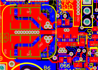

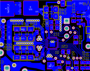

I built the system as in the diagram. Unfortunately, the BQ25672 system is damaged by an internal short circuit after switching on the charging. I damaged 13 pieces of BQ25672 in this way. I built two separate prototypes and both damages the same way.

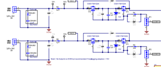

  • Hi Pawel,
    Do you have an input snubber from 2ohm, 2.2uF as shown on EVM below:
    Hot plugging >15V power supply can result in inductive ringing >30V max input voltage, which damages the chip.
    Also, with 4S battery, you need similar protection for BAT and BATP pins
    Jeff

    I do not have a snubber (2R + 2.2uF) at the board input, only 2x 22uF + 100nF MLCC + Zener diode 24V 3W 1SMB5934BT3G. I powered it directly from Hameg HMP4040.
    The damage to the system occurred after switching on the charging by connecting the /CE input to GND or connect NTC. The supply voltage was constantly connected.
    TVS diodes to BAT and BATP are connected (D42, D44), 47n also (C51)

    The damage is likely overvoltage.  Did following recommend layout in the datasheet and EVM user's guide?  This layout minimizes ringing on the SW nodes.  Do you have oscillscope to look at the SWx nodes when operating at a lower voltage?  If there is ringing on the SWx nodes at lower voltage, it will only get worse at higher voltages.
    I am unable to access your google drive.  Can you send me a pdf of your schematic?

  • My PCB is a bit different, because it's just a two-layer PCB. But the distances between the IC and the capacitors are also very small. After the weekend I'll get a new batch of ICs and then I'll check the voltage waveform on the SW pins.
