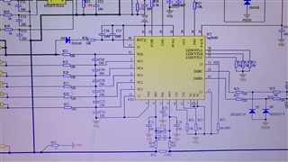

Can you please confirm the connection of the sense resistor to the SRP/SRN pins? This reading is much greater than the maximum value that can be reported to this register. Is FET_EN set at this time as well?
Anthony
How can the connection of the pins be confirmed, and are they embedded in the battery box?
Please check what the current being passed across the two points below going directly into the SRP/SRN pins are compared to what is being passed across the sense resistor:

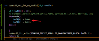

FET EN is configured what function how to confirm
Please confirm whether this bit is set in the Manufacturer Status register of the device.
Anthony

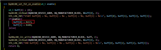

Please use the FET Control command below, which is 0x0022.
Instructions on how to send a command can be found here:

No battery charging . when init start ,set 0x44 and sent 0x0022, It still seen the current ma is 65401, please to analyse,
and battery charging , current ma is normal.
