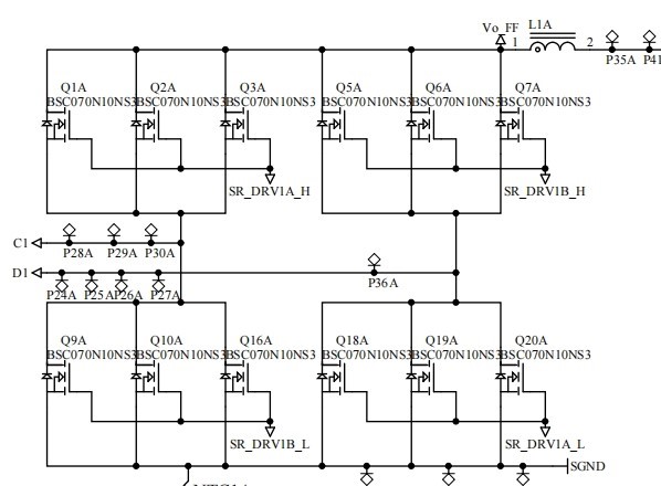

Is there any workaround which can reduce the reverse current of internal boot diode? customer found 2pcs failed device when carrying out internal test., and Pin1 and Pin2 are shorted both.

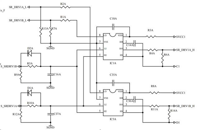

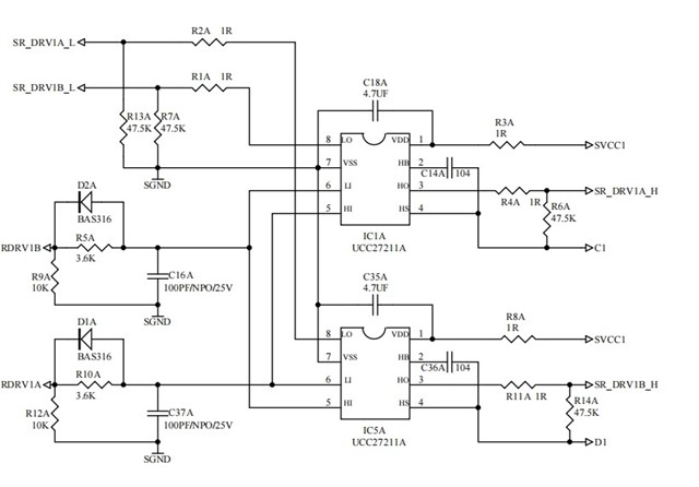

    2. The boot capacitor and VDD bypass capacitor may also be sized improperly, so can you share a full schematic that includes the component values and FETs?

  • Update schematic
  • Hi Harry,
    The current limiting resistor would go in series between the HB pin and bootstrap capacitor.
    Yes, you can use an external bootstrap diode, and it may help in preventing damage due to reverse current. This app note explains how to design and select for a bootstrap diode and bootstrap capacitor. You can also use that app note to doublecheck if the current bypass capacitor value fits the requirement.
    Please let me know when you receive the system characteristics, and make sure HB and VDD are not exceeding abs. max specs.
