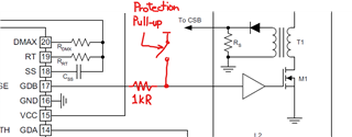

  • Hi Ulrich,
    Our customer is considering a protection circuit that will keep the PFC FET on during an abnormality and blow the fuse.
    Is this possible if there is a strong pull-up when VCC=0V?
    A weak pull-down circuit will be destroyed, but that's okay.
  • Hi Hirotsugu-san,
    I understand your original question better now.
    A strong pull-up from a special protection circuit can over come the UCC28070 gate-drive weak pull-down when VCC = 0V, but the pull-up will have to be very strong when 0V < VCC < 8.8 V.
    The UCC28070 gate-drivers are not characterized to drive MOSFETs directly and it is expected that gate-drive ICs or buffer circuits are used to interface the GDx outputs to the PFC MOSFETs.  However, the GDx outputs really are actual gate-drive drivers adapted from a different IC and have significant pull-down strength when VCC is > ~2V.    It is not clear at what VCC voltage the pull-down strength becomes significant; probably somewhere between 1V < VCC <3V.
    The exact value is not important, and may vary from IC to IC. What is important is that the special protection circuit may be required to act for some reason when VCC on UCC28070 is >0V, even if < 8.8V.  In that case, a direct protection pull-up will face a fairly low-impedance pull-down from the UCC28070 driver outputs.
    To avoid this, I suggest to insert a 1kR resistor in series with each GDx so that the protection pull-up only has to drive a 1kR load (approximately).
    The 1kR series resistors will not produce significant time delay for normal PWM signals to the gate-driver IC due to input-pin capacitance (typically 5pF, for example).  And 1kR will limit the current so that the UCC28070 is unlikely to be damaged.
    Lower values of series resistors will reduce PWM time delay even more, but will allow higher pull-down driver current.  At some lower resistance, the risk of gate-drive damage becomes significant.  Your customer can make the trade-off between minimizing PWM delay time and minimizing protection circuit pull-pup strength.
