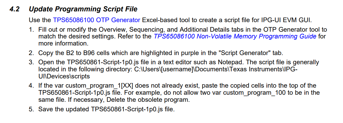

I am attempting to use the TPS65086100 OTP Generator V2p5 to import into the IPG-UI in order to program the above EVM. The JSON (collated from the "Using IPG-UI" tab in the "Script Generator" sheet of the calculator, see the JSON below) fails to import, see the error below.
  1. What is the expected structure of the JSON accepted by the IPG-UI, is there documentation that indicates what structure it should follow
  2. Is there a better method to generate the JSON from the Generator that I am missing
"The file selected does not appear to be a valid device description file. Please verify the file and try again. If this error continues it could be due to a file that is not compatible with this version of the GUI. Please check www.ti.com for updated device description files"
The related device description file (copied from the generator):

  • Hi Helios,
    The contents of the script generator should be copied into the existing "TPS650861-Script-_p_.js" file located in the IPG-UI folder on your computer drive
    (full path in bullet 3 of the photo below)
    Please follow the steps outlined in the 4.2 section of the BOOSTXL-TPS650861 EVM User’s Guide:
    I understand you are using a different EVM , but the procedure should be the same.
    The TPS65086100 Programming Guide is another document that may have additional programming instructions.
    Sarah
  • Thanks for the update. I ended up finding the instructions above and successfully loaded my configuration from the OTP generator.

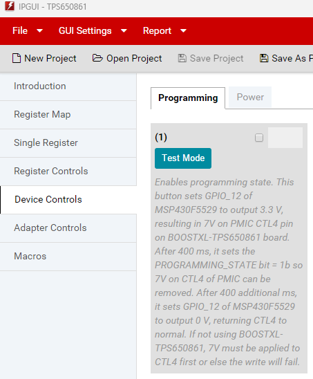

    I have a seperate issue (can open another forum post if necessary) where I cannot put the PMIC into "Test Mode" / Programming Mode. Following Step 8 in the "Programming Steps" section of the BOOSTXL-TPS650861 EVM User’s Guide.
    Receive 2 messages:
    1. Programming state enabled
    2. USB2ANY Failure: -44 ERR_I2C_ADDR_NAK
    According to USB2ANY spec: Address not acknowledged (NAK)
    In the "Device Controls" section the Test Mode description text (quoted below) refers to the BOOSTXL-TPS650861 board, while I am using a TPS650860EVM-116. Is there different device support that needs to be installed for this EVM? If not, than how can I enter Programming Mode on my EVM?
    Test Mode description in "Device Controls" menu:
    (1) Test Mode: Enables programming state. This button sets GPIO_12 of MSP430F5529 to output 3.3 V, resulting in 7V on PMIC CTL4 pin on BOOSTXL-TPS650861 board. After 400 ms, it sets the PROGRAMMING_STATE bit = 1b so 7V on CTL4 of PMIC can be removed. After 400 additional ms, it sets GPIO_12 of MSP430F5529 to output 0 V, returning CTL4 to normal. If not using BOOSTXL-TPS650861, 7V must be applied to CTL4 first or else the write will fail.
  • Hi Helios,
    Are you providing power to the EVM board in any way? I have seen this NAK error when power is not sufficiently provided.
    Please ensure the sufficient VSYS is being provided.
    I also want to confirm that even though you are using the TPS650860EVM-116, have you swapped the main IC with the User Programmable TPS650861 ?
    For programming, a stable 7V needs to be provided to CTL4 pin. The BOOSTXL-TPS650861 accomplishes this internally with a MUX
    For your case, you would just need to ensure that you can provide 7V to this pin.
    Sarah

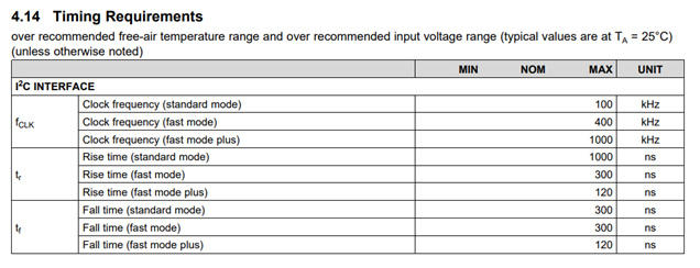

  • Afternoon Sarah,
    I am reviving this thread as we are having further issues using standard I2C hardware to write to the TPS65086100 PMIC on our development board. Are there any particularities with timing that should be adhered to? The issues are quite unusual, as the registers can be read (inconsistently) and not written to. Considering the PMIC is on our board with an exposed I2C header, would you recommend any TI hardware for interfacing with it?
    Thank you,
    H.
  • Hi Helios,
    Here are the expected timing values for the I2C interface:
    Can you clarify what mircocontroller/hardware you are currently using on your development board to perform I2C read/writes?
    And is there a specific register(s) which you are having trouble writing to? The inconsistent reading is strange,
    but are you able to cross-reference your registers with the register map listed in section 5.11 of the datasheet,
    to ensure they are on the list of registers that can be accessed without being in programming mode?
    Sarah

  • Apologies if I was unclear, yes I confirm I am seeing no toggles on the USB2ANY I2C lines when writing values with IP-GUI (verified with external Salae logic analyser). I can also "read" from the USB2ANY device (not the PSU board connected via I2C) -- it is as if there is a buffer in USB2ANY that contains some relevant register values.
  • Hi Helios,
    Are you able to share some images of your physical setup, along with what you are seeing on the IPGUI?
    Just so I can get a better understanding here.
    Are any errors appearing in the top right corner when you get a failed attempt to write?
    I also want to confirm the I2C address in the Register Map tab is set to 0x5E ?
