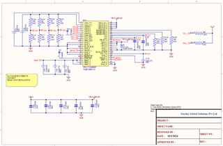

Internal doesn't Pwer On
Hi Sri,
While I review your schematic, would you mind clarifying what you mean by internal doesn't power on?
Conner
Schematic Checklist Rev 2p0.xlsx
Please review the attached schematic checklist (Tab TPS25730D). The reason for the issue you're seeing is that the FAULT_IN/ pin isn't setup correctly. For this pin, connect to LDO_3V3 through resistor.
Hi Conner,
Thanks for your guidelines.
Here I have connect the fault_In Pin to LDO_3V3 Through 10K res. nothing is happen .
Internal regulator 3V3 & 1.5V Regulator does not getting ON . while the Input was 5V through USB C type
Can you please clarify the behavior you're seeing? Are you able to capture any plots of VBUS and LDO_3V3?
