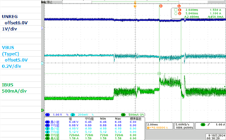

Please tell me the following about OCP detection operation when outputting from PP5V to USB.
(1)How to set the output to 5V0.9A and output a peak of 1.6A (approximately 5ms)
(2)IC operation specifications
     -OCP detection threshold when set to 5V0.9A PDO
     -OCP detection period
     -PP5V_UVLO setting value when outputting SRC
     -Register setting related the above
・Waveform

    (1) requirement is just a Type-C(non-PD) ,but I also set PDO.
        In my setting, I get OCP waveform below (5V1.5A setting).
         -PDO 5V0.9A  : detected approx.1.2A
            setting /Reg29h=0x01100000
                         Reg32h=0x2601905A2AA801
         -PDO 5V1.5A  : detected approx.1.77A
            setting /Reg29h=0x01100001
                         Reg32h=0x260190962AA801
         ※Common:Reg28h=0x2F4902  →OVP setting3 (114%)
                    →I_LIM5V is also set to 114% or setting X?

    Is the PP5V ILIM set as below?
     -PDO=5V0.9A  : setting0 1.15~1.36A
     -PDO=5V1.5A  : setting1 1.61~1.90A
    >The duration of the overcurrent event before disabling PP5V is tILIM: 5.1ms
    So if the VBUS current remains above the ILIM value for 5.1 ms, the PP5V output will stop?
    If the VBUS current falls below the ILIM value, will it be reset at that point and the time will start counting again?
    Will the OCP be detected in the waveform below when set to 5V0.9A?
     ※Same waveform as the first post
    If the VBUS current exceed setting 0 (1.15A-1.36A) for over 5ms then OCP will not be detected.
