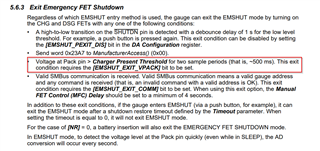

    SHUTDOWN MODE Exit Timing: According to the datasheet, the BQ40Z50 exits SHUTDOWN MODE when a charge is applied, with the requirement being >3V. However, the datasheet does not specify how long the voltage needs to be applied for the device to exit SHUTDOWN MODE. Is there a defined time duration for this condition, or any available test data that provides insights into this?
    I believe the voltage on the pack pin needs to be apparent for at least two sample periods of 500ms length. The image below is for the emergency FET shutdown, but I believe the sampling on the pack pin in shutdown should work on the same timing factor:
