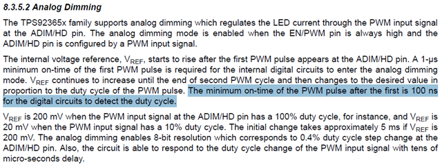

  • Hi Steven,
    I am wondering if you misinterpret the "switching FET minimum on time" (t_min_ON in Section 7.5 Electrical Characteristics from the datasheet) here as the minimum the pulse for the AIDM/HD.
    What is the minimum pulse for AIDM?
    This device only has 8-bit resolution (256 steps) for analog dimming. You cannot have more steps than this value.
    What does 8 bits only mean?
    I believe that frequencies above 39khz will be 6bit dimming.
    My understanding is that there is a minimum ON time and the cycle/minimum ON time can be the resolution.
    Ryu.
  • Hi Ryu,
    The minimum on-time of the PWM pulse after the first is 100 ns for the digital circuits to detect the duty cycle. Please refer to Section 8.3.5.2 Analog Dimming from the datasheet.
    The reference voltage for current sensing is generated by an internal DAC, which has a resolution of 8 bits. This sets the higher limit for the steps of analog dimming that this device can achieve.
    Steven

  • Hi Steven,
    Let me confirm one point just to be sure.
    In the data sheet “8.3.5.2 Analog Dimming” it says that the minimum pulse for the ADIM/HD pin is 100ns.
    But you tell me it is 150ns.
    Which is correct?
    Ryu.
  • Hi Ryu,
    Our expert will give you reply later.
    BR
    Patrick
  • Hi Ryu,
    Which is correct?
    Datasheet is correct. Sorry, I made a mistake in the previous post. Let me correct them so that they will not mislead other people. Thanks for pointing this out.
