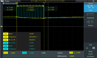

  • Dear Garrett,
    I got the plot for blinking LED.
    please refer to the measurement waveform.
    Yellow (CH1) is bat1,2 and Blue (CH2) is CHG/ pin.
    What I want should keep blinking, but it's not happening.
    Seungyooon
  • Hi Seugyoon,
    Please see my comments below.
    I want to get your email address so I can send my schematic.
    I have sent you a friend request via E2E. Once you accept I can share my email address via private message, alternatively if you wish you can simply share your schematic file via private message feature on E2E.
    Thank you for providing a waveform of the behavior. Based on my review I believe I have determined why /CHG LED stops blinking in your system.
    It appears to be due to the drop in VBAT when charge is suspended due to timer expiration. I have verified in our lab that battery voltage dropping below Vbat(sc) threshold (battery short circuit threshold, typ 1.8V max 2V listed on datasheet page 7) results in a reset. When VBAT reduces /CHG LED turns off and device is no longer in 'safety timer expired' state.
    If you repeat your test but ensure battery voltage remains in precharge range (>2V and <3V) I expect device to stay in continuous operation with charge suspended and /CHG LED flashing at 2Hz.
    Garrett
