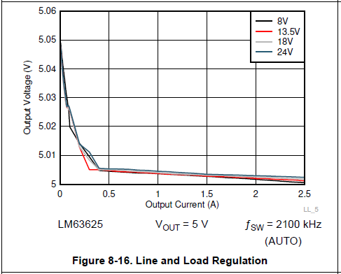

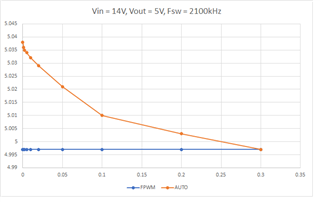

Customer use case : Vin = 14V, Vout =5V, Iout = 300mA, Fsw=2.1MHz, FPWM( or Auto mode)
(1) Could you provide below data when Iout = 0A to 300mA load condition?
(2) Could you provide graph of Figure 8-16 with FPWM condition?
