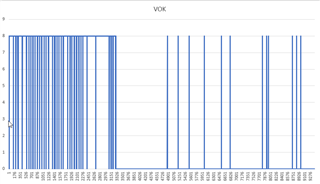

  • Hi Pingyu,
    Thank you for sending the files. In the data sent, the movement of the REST and VOK bits are very abnormal, since these bits do not toggle at the rate being seen below. Is this test being conducted on the bq40z50EVM or a custom PCB? Also, has the firmware been reflashed to the device and tried again?
    Anthony
  • Hi,Anthony.
    Thank you very much for the guide, we used our own product system board to do the test, I will try again as you suggested.
    Pingyu

  • Hi,Anthony.
    Thank you very much for your patient reply.In the Discharge→Rest→Charge→Rest cycle of learning, Updatestatus=0x04 has been successfully updated to Updatestatus=0x05.
    But in the next discharge rest session, after 2 hours of rest, Updatestatus=0x05 has not been successfully updated to Updatestatus=0x06. May I ask if it is necessary to let [GAUGE_EN] set before discharge rest every time for Updatestatus to be successfully updated.
    I have uploaded the gg file and log file, can you please analyze what is the reason?
    Regards.
    Andy20241021data.gg.csvreg1.log
    No, this is not necessary. GAUGE_EN should only be set on the first discharge.
    Regarding the learning cycle, the movement of the VOK and REST bit seems abnormal, however there are sections of the data that do not seem to be read correctly. Can you please confirm the communication connection to the device?
    The REST bit does not seem to become set until the end of the 2 hour period as well. is there any standby current being passed during this time?

  • Hi Pingyu,
    Understood, it does not seem like the charge FET is being disabled in the log file, so the gauge should be able to charge at this time. Can you please tell us how much charging current is being used during this time? Is it the same as the previous charge in the log file?
    Anthony
  • reg3.log Hi, Anthony,
    Thank you very much for your kind help, I've found the reason why it's not charging, and it's due to a firmware anomaly in the device.

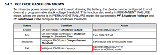

    I know the real reason now, it's because BQ40Z50 entered shutdown mode, but I couldn't find out which protection triggered the shutdown mode. I tried charging to release the shutdown mode, but it still didn't work. I tried other methods, but they didn't work either. Finally, I can only replace the BQ40Z50 chip. Apart from replacing the chip, can you provide a method to release the shutdown mode?
    Also, I would like to ask if BQ40Z50-R2 can monitor the device's battery life. If so, where can I find it? thank you.
    PingYu
  • Hi Ping Yu,
    The device should exit shutdown mode if the voltage at the PACK pin is greater than the Vstartup value.
    Bq40z50-R2 can monitor battery life through the State-Of-Health value. More information on this can be found in Section 6.7 of the bq40z50-R2 TRM.
    https://www.ti.com/lit/ug/sluubk0b/sluubk0b.pdf?ts=1732292918733&ref_url=https%253A%252F%252Fwww.ti.com%252Fproduct%252FBQ40Z50-R2

    1. Continuing with the issue discussed last time: BQ40Z50 cannot be restored after entering shutdown mode.
    I have identified the cause of BQ40Z50 entering shutdown mode: when programming new firmware, the device did not have a battery installed, causing BQ40Z50 to not detect the battery and enter shutdown mode, which resulted in BQ40Z50 and bqStudio being unable to communicate.
    However, following your instructions of 'Voltage at PACK pin>Vstartup' and applying an 8.4V voltage to the PACK, the BQ40Z50 still cannot return to normal mode. Currently, the only way I have tried to restore it to normal mode is to replace it with a new BQ40Z50 chip. Could you please help analyze and confirm if the method in the bq40z50-R2 Technical Reference is the solution to the situation mentioned above?

  • Hi Andy,
    Just to confirm, at this time where a voltage greater than Vstartup is applied, are the cells or power source connected to the device? Is proper power reaching the BAT pin?

    Regarding the charge being stopped, it seems like the PCHGC protection is being triggered, in turn disabling the charge since [XCHG] = 1 in the trip actions below:
    Anthony
  • Hi Anthony,
    1."When programming new firmware for BQ40Z50, as long as the device is not equipped with a battery, it will enter shutdown mode and cannot be restored."
    This means that when programming new firmware for BQ40Z50, if the device is not connected to the battery, i.e. BQ40Z50 is not connected to the battery, during the programming process, BQ40Z50 will enter shutdown mode and cannot be restored.
    In this case, after charging at a rate of approximately 130mA for a period of time, PCHGC protection will exit until the battery is charged to around 3000mV, at which point the device will no longer charge. I'm puzzled why the charging stops. Normally, it should continue charging until fully charged. I have sent you the log of the charging process, please check the specific reason through the log.
    1050.reg.log
    Thank you for sharing the log. While looking through this, I do not see the PCHGC protection trigger based on the SafetyStatus register values. Do you have a log of the point where this triggers so we can see why the charge FET is being disabled?
