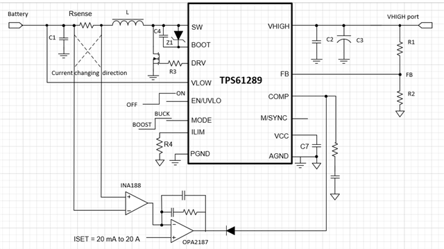

  • Hi Christian,
    1. For TPS61289 or most boost, it will be hard to start at low voltage like 1V but after start, it can work with VLOW as low as 0.5V
    For device like TPS61299, it can start at 3.5V(Only with VLOW) or 3V(with VHIGH connected)
    2. please below block for capacitor discharge.
    After start up, the device can use a sense resistor to implement the const current control.
    When VHIGH reaches the target (programmed by R1,R2), the device enters voltage loop.
    For the capacitor charge, the FB need to connect to VLOW side, also, the current direction should be changed with the amp.
    3. For TPS61289 ,you could consider its comp to current as a voltage controlled current source.
    The comp can source current and thus can be clamped by external amp voltage.
    When working with voltage ,the diode is blocked and the device is regulated by its RC compensation loop.
    Fergus
