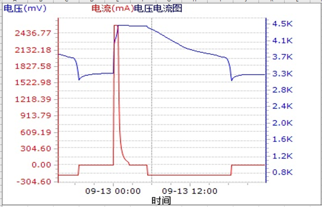

BQ40Z50-R1: battery pack chemistry ID issue
Part Number: BQ40Z50-R1
Other Parts Discussed in Thread: GPCCHEM
As requested, use 0.5c charge, 0.1c discharge, 4s capture data. After uploading to the website, the return message shows too large a difference between the data in the current chemical id table, as shown in the attachment, suggesting that there is no suitable current no suitable chemical is for selection. What should I do about this? Do I need to change the charge/discharge conditions to redo the data?
X0384214.zipX0384214-report.zip
