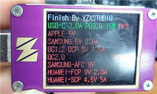

Hi Team,
We used the webtool to generate the low region file and issue to TPS25751 from ptch mode to app mode.
https://dev.ti.com/gallery/view/USBPD/USBCPD_Application_Customization_Tool/ver/1.0.0/
https://e2e.ti.com/cfs-file/__key/communityserver-discussions-components-files/196/1011_2D00_bc12dcp1.2vand2.7vcharging.bin
But it looks like that the typeC port didn't support BC1.2 DCP, 1.2 v and 2.7V charging. (red words)
I am not sure for the debug step, may you help let me know? Many thanks.
Currently, TypeC can achieve 5V/3A source and sink operation.
Roy

  • Hi Aya,
    We follow your instructions. But TPS25751 still can't support BC1.2.
    https://e2e.ti.com/cfs-file/__key/communityserver-discussions-components-files/196/1015_2D00_bc12dcp1.2vand2.7vchargingGpio4and5DplusDminusPinToAdc.bin
    And originally, it can support SAMSUNG 5V/2.0A, but now it can't.
    In addition, do we support importing the .bin file to load the corresponding setting?
    I choose the file, but it looks like it can't load in GUI.
    Roy

    We use below kit to identify if the typeC port support the BC1.2 or not.
    https://shopee.tw/product/599688065/22353217608?gads_t_sig=VTJGc2RHVmtYMTlxTFVSVVRrdENkZW5yaEhSSitqSzFrVnE3OVcxNVpXVlp2T0lGYUtHOG13Rks3TzVmWThKRnNhOVhJNVRib3dBTGZJVmROV200Z2NXVUI0aGErMEs1blY2a01jcEswVkN2bFhrcTFQOXVoU0Vobnh4emJIUno&srsltid=AfmBOorA-MxqmMFFmtJGvnZQtPyyHaWQNmoquw_b8oiHzjabEEEw-Vuze4s
    Roy
  • Hi Roy,
    It seems that Port Control register is set correctly for BC1.2. From a hardware perspective, GPIO4/5 need to be connected to D+/D- on the Type-C connector.
    Have you tried to test this configuration using the TPS25751EVM?
    I suggest capturing scope plots of the D+, D-, and VBUS lines and comparing with the application curves in section 9.2.3.3 in the TPS25751 datasheet.
    Aya Khedr

  • Hi Aya,
    I used the GUI today and only answer the questionnaire. Now it can enable the BC1.2. Please find the below .json.
    I ensure that I select the same answer in GUI. But I am not sure why it can enable BC1.2 now. The .json that you provided still couldn't enable the BC1.2 and the same issue using TPS25751EVM.
    And my question is that why can we enable the BC1.2 currently by using below setting and the difference between previous one.

  • Hi Roy,
    Thank you for the updates.
    I compared both jsons and it seems there are settings in the background that are different.
    One thing to note is that GPIO 4/5 Analog Input Control should be set to "ADC" like below.
    Could you please test with the following change and let me know if BC1.2 enumerates properly?
    Aya Khedr
  • Hi Aya,
    I imported the .json that your provided. The D+/D- also enabled as "Pin to ADC". But it can't enable the BC1.2.
    Please test with the updated json provided.
    Roy
  • Hi Roy,
    Thank you for confirming.
    I will replicate on my end with an EVM and get back to you by end of week.
    Aya Khedr
  • Hi Roy,
    Please see the latest GUI V1.0.2 in which the GUI auto-populates the configurations needed for BC1.2 support: https://dev.ti.com/gallery/view/USBPD/USBCPD_Application_Customization_Tool/ver/1.0.2/
    Aya Khedr
