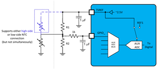

Please tell me about the temperature calculation method on page 235 of the datasheet.

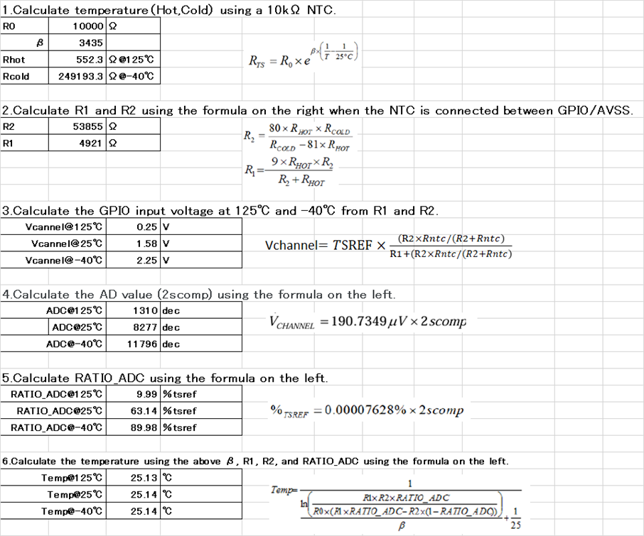

I wanted to measure an arbitrary temperature with the low side connection in the diagram below, so I calculated the cases of 125℃, 25℃, and -40℃ using the formula described in the datasheet.
The temperatures of 125℃ and -40℃ calculated using β, R1, R2, and RATIO_ADC are not the original temperatures, and I don't know where I made a mistake in the calculation.
If you have any examples of temperature calculations using the formulas on the datasheet, please let me know.
