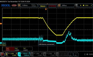

I am hoping that you will be able to help me with an issue that we have on the VBUS.
We have a device that uses the USB as a dual role and can use up to 15W of power.
The requirement is also that we support a host mode of operation when an USB flash drive is inserted into the device to transfer the files. In this case the device is powered through two different methods (both capable of at least 25W).
There are no issues when powering the device through USB but when we insert the USB flash drive some, by the looks of it, random spikes happen on the VBUS (picture attached below).
We also looked at the input PP5V line and it looks good. There are some ripples on it but not something I say that would trigger these spikes.

  • To clarify, you are sourcing 5V in the previous scope plot? If so, it is likely that the attached USB device likely momentarily drawing current past the current limit on PP5V, causing current clamping and the drooping of VBUS. If you take a current probe to VBUS, you can confirm this is what is occurring.

    I'm sorry for the delay. I finally managed to measure the current and it looks even weirder.
    The current seems to drop when we have a voltage drop as if the device crashed.
    Two different spikes below (happens on almost all flash drives - 5 different tested):
    Another interesting observation is that sometimes when we rotate the USB C flash drive it seems to work without those spikes.

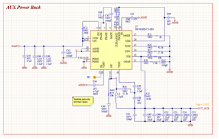

  • What is providing the power for PP5V? I see a net labelled "5V" but do not see what is providing it?
    And just to be sure, you are sourcing power in the above scenario?
    Conner
  • We have three different power sources here (AUX, PoE and USB).
    Since USB here is used for a flash drive (device acting as host so it's sourcing) we have to use either AUX or PoE. Both sources have a clean 5V output and it shouldn't affect the PP5V.
    We also run our SOM from the 5V line so if the 5V rail would drop so low we would have other issues as well.
    I'm attaching a schematic for the AUX power supply just in case. It's a 6A power supply but we are usually only sourcing around 10-15W (2-3A).

  • After ruling out configuration settings, and re-reviewing your plots, it looks like this only occurs when there is what looks like switching noise on PP5V and VBUS. Right before VBUS drops in every plot, the noise exists on PP5V and VBUS for a short period before dropping. This dropping is likely due to UVLO.
    I would recommend finding and reducing the cause of that noise  to see if you no longer experience the issue, or see if you experience the issue when increasing PP5V by 50mV or 100mV.
