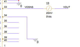

When trying to simulate the transient model in steady state mode with VOUT=5, I'm getting convergence errors everywhere.
It works fine in startup mode (STEADY_STATE=0).
Convergence errors happen with the average model as well (or it just gets stuck).
I've tried modifying just VOUT, modifying VOUT and the voltage/current loop parameters, etc.
Is there anything I'm missing that needs to be adjusted?

    Regarding the transient model in steady state, I am also getting a convergence error and looking into what's causing it. Since the model works fine in startup mode, the short-term solution would be run in startup mode, although it will take longer to run to get to steady because it has to go through soft start. Sorry for the inconvenience this may cause. The alternative would be to use our SIMPLIS model, which appears to be running fine at VOUT=5V without any issue. Let me know if this is a possible alternative.

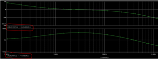

    For the average model, I have changed the way we apply the AC source as shown below. This helps fix the issue with convergence.
    You would need to change the way you probe the phase and gain as seen below.
