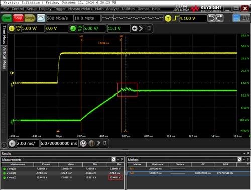

We are tesing TPS552892EVM found it have some unstable in power on, the peak ~13.46V,
Vout setting is EVM default = 12V. mode= FPWM, Iou= 0A.
May I know there have same behavior in your side?
Thanks!

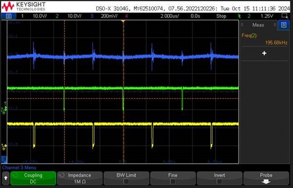

    We set Rfsw= 49.9kohm and FPWM mode but frequecy only 195khz, as datasheet caculation it shoud be 400khz, may I know any possible to let frequency going wrong?
    Vin =12V Vout = 12V
    CH1: SW1
    CH2: SW2
    CH3: Vout
    Thanks!

  • Hi Jeff,
    For question 1, it is device normal behavior during start up. We have 5step transition from PFM mode to FPWM mode. If you set PFM mode, this phenomenon will not happen.
    For question 2, at this time, device is working on buck-boost mode, so frequency for each mode is half and the total frequency is still 400kHz. You can slightly decrease or increase input voltage to let device work in buck or boost mode, then switching frequency will be 400kHz.

    2. After the output voltage is established, it takes 5 cycles to transition from PFM to FPWM.
      5.1 Under no load conditions, since PFM does not lock the minimum frequency, is there a chance that the operating frequency could fall into the audio range during the 5 cycles?
      5.2 Similarly, under no load conditions, referring to the power-on waveform previously provided by Jack, Vout experiences an overshoot issue, where it is set at 12V but spikes up to 13.46V. What methods can be used to improve this?

  • Hi Jeff,
    4.1 Do you mean output voltage will change with different input voltage? The voltage shouldn't change unless current limit is triggered. Can you describe Vin Vout Iout spec for different modes?
    4.2 Because without this function, frequency will be doubled, switching loss will increase and the efficiency will drop in buck-boost mode.
    5.1 It is possible. But the start up process only have 4ms, does this matter to your application?
    5.2 You can consider it similar to transient overshoot condition. By adding output caps and optimize compensation parameters(increase cross frequency) can help.

  • Hi Mulin,
    => I mean when input voltage change, due to output voltage is fixed, what is the change threshold between the Boost and buck mode.
    => We concern about the about the maximum 13.46V may cause output abonrmal since it have (13.46-12)/ 12 = 12% error.
    Seems in FPWM mode also have this 12% error on your EVM?
    => What is the suggest 1) adding output caps value 2) optimize compensation value in Vin11~13V to Vout 12V?
    Thanks!
    Jeff
  • Hi Jeff,
    4.1 There is some criteria for mode transition. The threshold is not fixed with different output voltage, switching frequency.
    5.1 Do you modify the EVM? Normally the error will not be that large. 5% is a reasonable range.
    5.2 It depends on your current BOM, including inductor, output cap PN, load current. You can slightly add some ceramic capacitors or change e-cap to a larger one by real test.

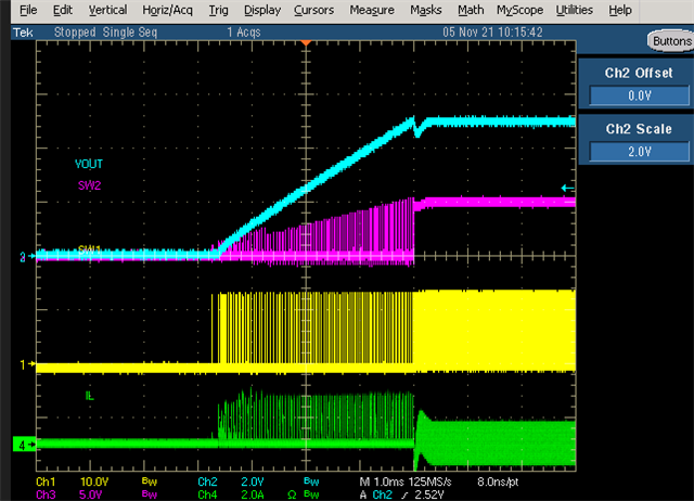

  • Hi Mulin,
    Your waveform is Vout =5V, Would you please try change vout =12V and in FPWM mode? Maybe can see the same voltage diff in start up.
    I'm check with customer other BOM they chaned. thanks!
    Jeff
  • Hi Jeff,
    I will wait for customer's BOM and do the test in the lab.
    Mulin
  • Hi Mulin,
    Seem becasue customer remove the output capacitor C19, the spkie seems acceptable by customer, I will close this thread. thanks!
