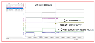

We have used tps7b7702qpwprq1 in our design to give power to an external amplifier.
We have an external ignition signal to put the overall circuit into sleep and wake-up .
In few conditions, when ignition is removed and given back immediately, the LDO is working and we are getting desired output. However for the above same condition, we also observe that the LDO's output is Zero.
Is there any minimum timing required to be maintained for on and off cycle of the LDO ?
This is happening randomly for 5 out of 10 boards which is not acceptable and I have attached the waveforms for your reference.

  • Hi Sreeram,
    I see that for the failing boards, the 'Short to battery and reverse current detection' feature is kicking in. Please see section 7.3.3 of the device datasheet.
    Each time the LDO switch is enabled on the rising edge of the EN pin or during the exiting of the thermal shutdown, the short-to-battery detection occurs. At this moment, if the device detects the short-to-battery fault, the LDO switch is latched off.
    As per the input voltage profile on the failing boards, the Vout-Vin differential lies outside the range specified for this feature in the EC table of the datasheet (as shown below)
    The device is functioning as intended. As a suggestion, I would avoid having Vin - Vout go below 500 mV. You can have some minimum load to drain the output faster when ignition is removed and that should resolve the issue.

  • Hi Sreeram,
    From the scopeshot/ simulation window you provided above for the case in which the boards fail, you can see that Vin drops momentarily such Vout - Vin is within that -500mV to 110 mV range by the time ignition is toggled. This is not happening due to the device and needs to be investigated further at the board- level.
    Yes, the device should operate normally when the short-to-battery is removed and the EN pin is toggled. Could you please toggle the ignition signal again and re-check?

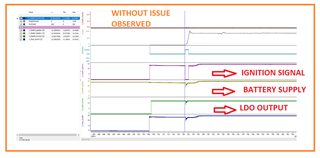

  • HI Ishaan,
    Kindly find my queries below:
    • With respect to the input capacitance, I can see that in the datasheet, there is a recommendation to use 10 uF but here 4.7 uF capacitor is used in the design. So, if we use the recommended input capacitor, will it improve the battery line voltage.
    • I am attaching here two images where we have probed input battery line, ignition and output voltage where we observed two scenarios: with and without issue and we were able to see that in both the waveforms, there is drop in battery line when ignition is pressed but in one case it is working properly while in the other case the output voltage becomes zero.
    • Kindly refer the below images for your reference.
    WITH ISSUE SCOPESHOT:
    WITHOUT ISSUE SCOPESHOT:

    • With respect to the input capacitance, I can see that in the datasheet, there is a recommendation to use 10 uF but here 4.7 uF capacitor is used in the design. So, if we use the recommended input capacitor, will it improve the battery line voltage. - Yes, this is possible. The input capacitor acts as an input filter for the LDO so it can smooth out disturbances on VIN caused by large impedances between supply and IN pin.
    • I am attaching here two images where we have probed input battery line, ignition and output voltage where we observed two scenarios: with and without issue and we were able to see that in both the waveforms, there is drop in battery line when ignition is pressed but in one case it is working properly while in the other case the output voltage becomes zero. - Is it possible to make cursor measurements for both cases between nominal Vin and minimum Vin (once Vin drops)
