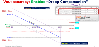

Hello experts
We are planning to use TPS62874 - 15A buck for one of our applications.
Could you clarify more about droop compensation. My understanding is when the droop is enabled during high current the supply voltage reduces to -12mV. For ex. if the current is 50A and voltage 0.8V initially when the high current is drawn the voltage reduces to 0.788 so the power reduced to 39.4W from 40W. so a savings of 0.6W.
Is my understanding right?
