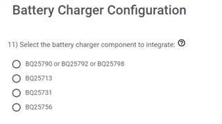

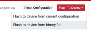

  • I tried to export JSON and binary files for TPS25751, from the tool, but it appears to be blocked.
  • Hi Rafal,
    It looks like you did not select a battery charger in question #11. Please make sure to answer all questions, the GUI should then allow you to export settings.
    Also, please generate a new json for the TPS25751, you should not import settings from the TPS25750.
    Aya Khedr

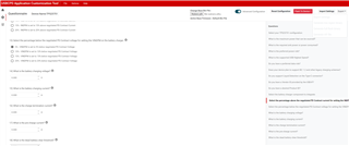

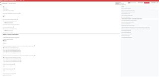

  • Still not working. i have clickout all  possible queastions, in basic mode, and I tried even in advance mode
  • Hi Rafal,
    From the screenshot above, it appears questions 9 and 10 are unanswered.
    Aya Khedr
