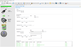

 I am attempting to change the UNSEAL keys using the Advanced Comm SMB commands via bqStudio.
I followed an example from a previous post to try it out to see if it works, however my results have not been successful.
The steps I followed were from this previous post:
https://e2e.ti.com/support/power-management-group/power-management/f/power-management-forum/781400/bq40z50-r1-change-security-keys
I followed those steps except this is what I see when entering the commands:
Note when I Read Block command=23 I get a value that doesn't match as I was attempting to confirm the new key matched.
I then tried to SEAL the pack to test it out and now the changed unseal keys do not work, nor do the default keys.
Is there something I am doing incorrectly?
I have another pack that I can use to try to change the keys from scratch.
Kevin
  • Hi Kevin,
    Was the gauge in a fully unsealed state when these changes were made? If the gauge is in sealed then I do not believe reading back will produce the key values. If the gauge was unsealed during the time the keys were changed, did reading 23 back out show the right keys/
    Anthony
  • Hi Anthony,
    The gauge was unsealed when performing the key change.
    I was able to unseal the pack with the new keys.
    I had entered the values incorrectly using the Commands UNSEAL prompt.
    I believe it's supposed to be in little endian format which I didn't do the first time.
    It's working now even though the Read Block doesn't read back the right keys.
